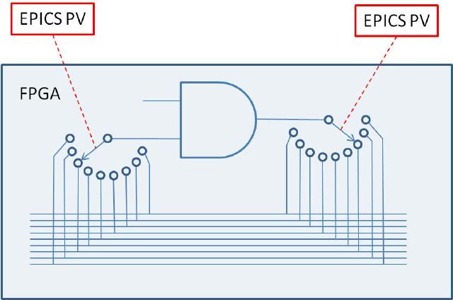

Here's the underlying idea, schematically:

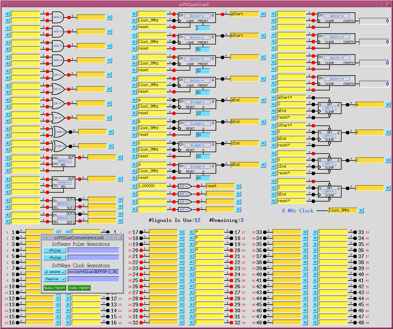

User Menu
softGlueMenu.adl is the top softGlue display, which serves mostly to call up other
displays. The menu labelled READ PERIOD specifies the period at which the values of
all signals are sampled for display to the user.
Most softGlue displays are not interrupt driven. (That would be a disaster, because inevitably some signals will change state at high frequency.) So, the states of inputs and outputs must be sampled periodically, for display to the user.We've found that it's confusing for users if the poll period is greater than around 1 second. We've also found that polling everything at .1 second uses only a few percent of an MVME2700 CPU.
AND
On the left of the AND gate are the inputs, each comprised of a blue "= button", a yellow text-entry field, a number, and what's intended to look like a red LED. On the right are essentially the same things in reverse order, but an output's text-entry field is a different color. The text-entry fields are used to connect signals together, and the color difference is intended to remind you of the only rule governing signal connections: if you connect two or more outputs together, those outputs won't work.
softGlue outputs are engineered to ensure that you can't break anything by connecting outputs together, but the circuit won't be useful until you fix the error, because the states of outputs connected together are undefined. Currently, softGlue doesn't signal this error by putting offenders into an alarm state.
The yellow text-entry box controls an input. You have three options:
This directly writes a logic value (optionally, a pulse) to the input.
softGlue will parse everything that looks numberish, and convert to a floating point value. This sets the input to a logic value: 0 if the nearest integer to the converted value is zero, 1 if it's not.
Allowing floats, and extra characters after the number makes it easier to drive softGlue inputs with calcout records, replies from serial devices, etc.
The strings "0!" and "1!" (possibly followed by other ignored characters) direct softGlue to
write a pair of logic values: "0!" writes "0" followed immediately by "1"; "1!" writes "1" followed
immediately by "0". The time interval between writes is system dependent, and not at all
guaranteed, but it should be much smaller than the interval you could achieve from separate writes.
On an MVME2700, I measure around 6 μs.
This names the signal, and connects it to all other signals with the same name (or with the
same name followed by '*', as described below). Case is significant in comparing
signal names.
Note that a "signal", as the word is used in this documentation, is a named connection between softGlue circuit elements. It might be more intuitive to think of a "signal" as a wire, to avoid confusing it with, say, field I/O.
Note, if you're using more than one IP-EP20x module, that you can't connect signals implemented in different IP-EP20x modules using their text-entry boxes. To accomplish this, you must connect the signals to field I/O and make a physical connection.
If you want to use the inverted value of a signal for input to some component, append
'*' to the signal name. This doesn't change the signal that the input is
connected to, but just tells softGlue to run the signal through an inverter before applying it
to the input. Note that output signal names may not end with '*'.
In MEDM, you can use Drag-And-Drop to connect a named signal to some other signal. When you drop, MEDM will put the PV name of the signal you dragged from. When you press <Enter>, softGlue's device support will write the signal name of the source PV to the destination PV.
In caQtDM, you can select the text of a signal name, and use Copy/Paste (^C/^V) to copy the signal name from one text-entry box to another.
Whatever option you choose, you can define at most fifteen different signal names. When you try
to define the 16th name, softGlue will erase whatever you wrote, and put the record into the
"INVALID" alarm state. (But note, for example, that reset and reset* are
not different signal names, because the trailing '*' is not regarded as part of the
name; it merely describes how the signal should be used.)
Text-entry boxes for output signals won't accept names beginning with a number, or ending with
'*'. (softGlue will simply strip the offending characters, and leave the rest.)
A signal name beginning with a number can only be a direct-write command; it cannot connect things together, because the leading number would be misinterpreted by input-signal-name parsing as a direct-write command. Output-signal names ending with '*' are logically sensible, but are not permitted; this simplifies the implementation of '*' appended to input-signal names.
A signal's blue "= button" is used to find all other signals to which the signal is connected. While a signal's "= button" is pressed, input signals connected to it are bordered in green, and output signals connected to it are bordered in orange. If you ever see two or more orange borders at the same time, you have outputs connected together, and your circuit won't work.
The little red and black filled circles (LED's), and the numbers next to them, display the states
of their signals. These display elements are updated at the period specified in the
softGlueMenu.adl display. If you want the EPICS PV name corresponding to a signal's
logic value, this is the PV name to use.

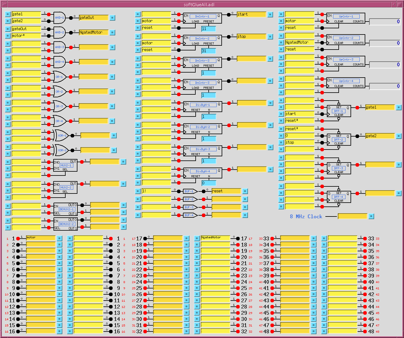

Everything on one display, with the signal named "clock" highlighted so that all of its connections are evident. A signal name gets this treatment when the "= button" next to an input or output is pressed. Note that connections to inputs are bordered in green, and connections to outputs are bordered in orange.
This display shows everything in softGlue except interrupt support.

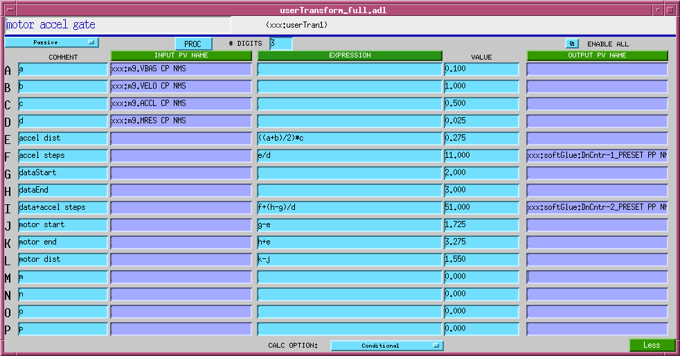

This display controls two pulse generators implemented in EPICS, with links allowing them to write to a softGlue input (that is, to a yellow box), and, similarly, two clock generators implemented in EPICS. The display also has MEDM related-display callups for two busy records,
The use of EPICS links (the purple boxes in the above display) is described above in the section "About EPICS links", in the documentation of "Field I/O Interrupt support".

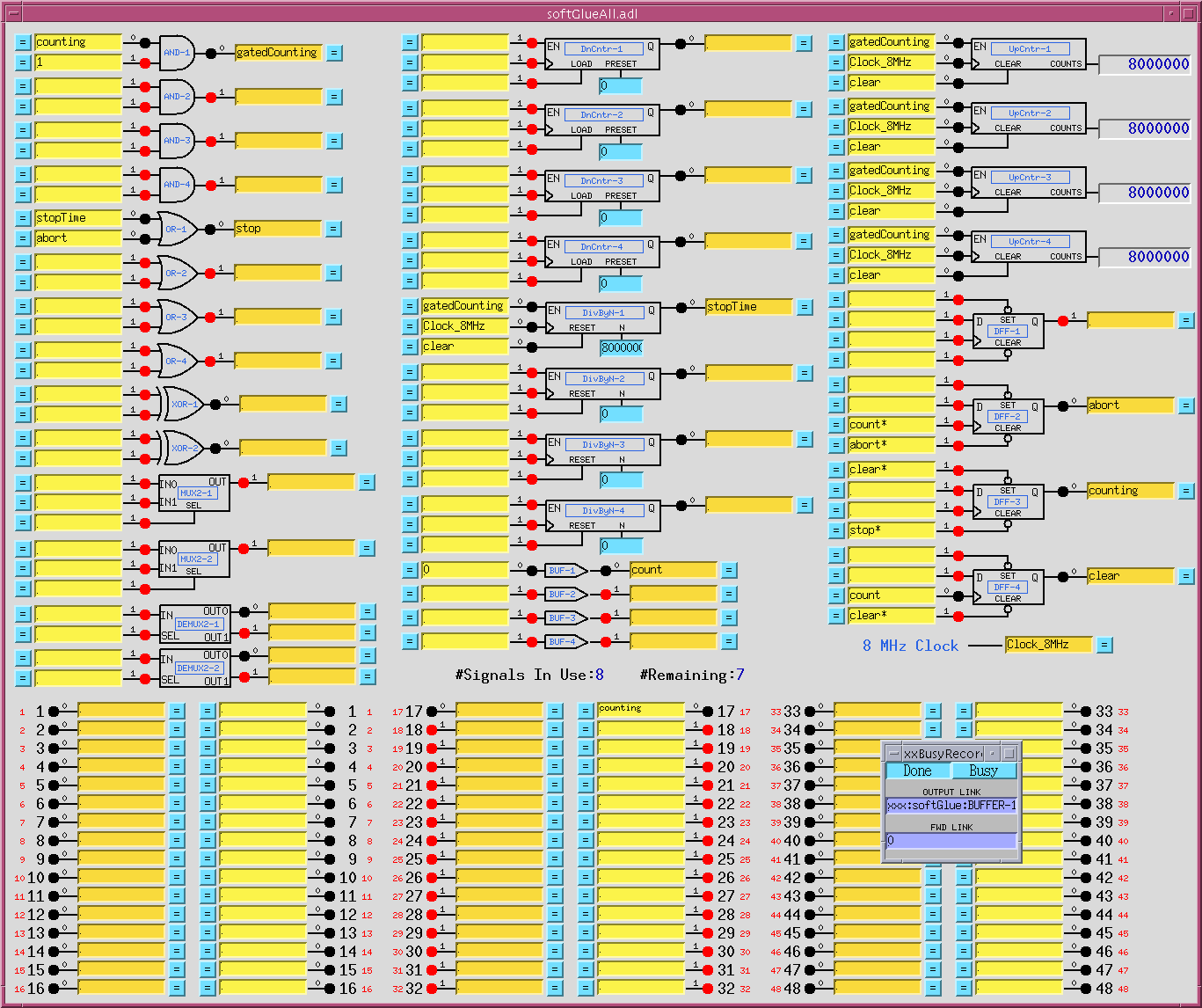

Negative-going pulses can be gated with an OR gate, by applying the signal to one input of the OR gate, and setting the other input to 0(1) to allow(deny) passage through the gate.
Files:
softGlueApp/op/burt/gatedScaler.snap or
iocBoot/iocSoftGlue/gatedScaler.cfg
This circuit implements four counter channels, a time base to control
counting time, an overall gate, and additional circuitry to control
starting, stopping, and processing of the count-value records. Note
that the scaler is controlled by a busy record from the softGlue
convenience database, so that client software can discover when counting
is finished in the standard EPICS way. See
softGlueApp/op/burt/gatedScaler.txt for more details.

The following circuit accepts negative-going motor pulses at input signal 1, gates out
the first 11 (the value of DnCntr-1_PRESET), and from then on sends motor
pulses to output pin 17 until a total of 31 (the value of DnCntr-2_PRESET) have
been sent. The circuit is reset by writing "1!" (positive-going pulse) to the input of BUF-1.
The circuit includes some diagnostics, and a mechanism for testing:
UpCntr-1 counts all motor pulses; UpCntr-2 counts gated
motor pulses. Both counters are reset by the same signal that resets the gate circuit.
Down counter DnCntr-1, and flipflop DFF-1, together produce a gate
signal that is 0 after a reset, and that goes to 1 after DnCntr-1_PRESET motor
pulses. Down counter DnCntr-2, and flipflop DFF-2, together produce a
gate signal that is 1 after a reset, and that goes to 0 after DnCntr-2_PRESET motor
pulses. We load the number of acceleration steps into DnCntr-1_PRESET, and the
number of acceleration steps plus constant-speed steps into DnCntr-2_PRESET.
AND-1 combines the gate signals produced above into a signal that is 1 while
the motor is moving at constant speed.
AND-2 gates the negative-going motor pulses, using what
was described in the "Motor-pulse gate" example as a
positive-going-pulse gate, by inverting the "motor" signal before
applying it to the gate.
Note that the down counters are clocked by (rising edges of) "motor", to produce the
signal used to gate "motor*". This choice avoids a race condition between simultaneous
rising edges of "gateOut" and "motor". (This circuit gates negative-going motor pulses, so
another way to make the point is to say that the trailing edge of a motor pulse is used to
produce a gate that will be ready in plenty of time for the leading edge of the next motor
pulse.)
Calculations for the circuit are shown in the following screen capture of a transform record.

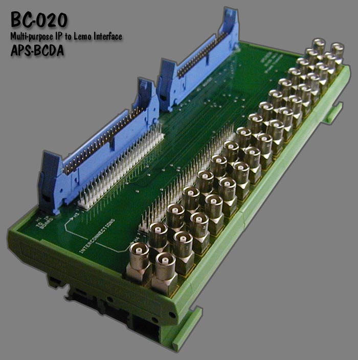

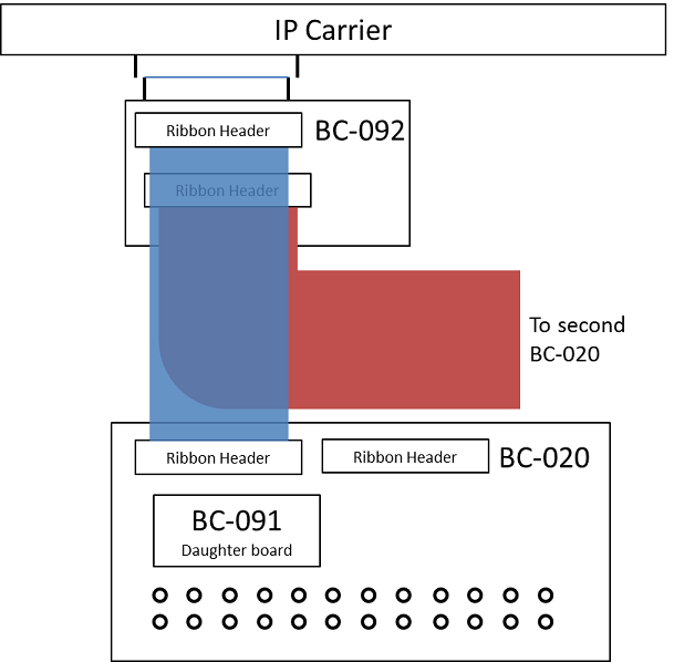

The APS BCDA group has produced three circuit boards that implement this strategy:
The BC-092 plugs directly into the IP carrier's 50-pin ribbon connector.
(Take care: the connector is not polarized. It's your job to plug it in the
right way.) A ribbon cable goes from the BC-092 to the H1 ribbon
header on the BC-020 board. (The H2 header is not used for

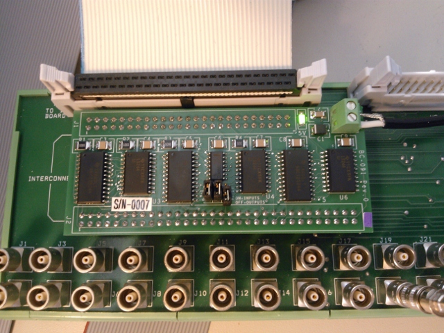

softGlue.) The BC-091 daughter board is plugged into the BC-020, and the I/O
direction is set, for groups of eight bits, with DIP jumpers on the BC-091.
The BC-020 LEMO interface. With the EP-201 board, only the first 24 LEMO connectors are used. The BC-091 daughter board is plugged into the white headers at the center of the board.
A BC-020 board with the BC-091 daughter board installed. Note the DIP jumpers near the center of the daughter board. With this setting, I/O pins 1-16 are inputs (jumper on), and pins 17-24 are outputs.

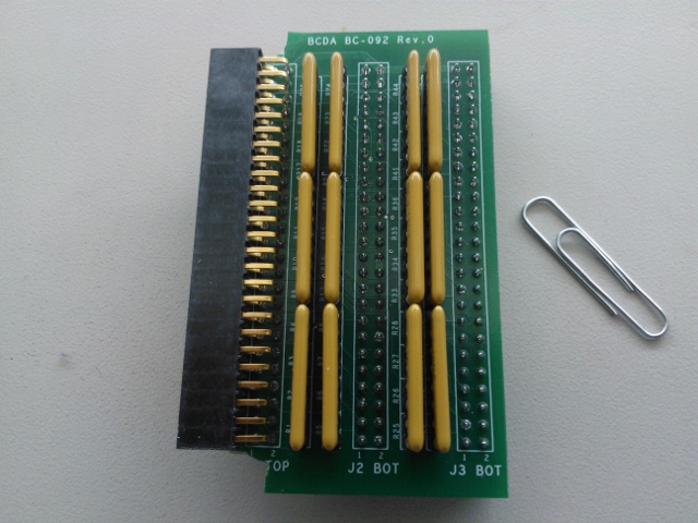

Closeup of the BC-092 board, with SIP resistor packs installed. Normally, 100-Ohm resistors are used, because this is the nominal impedance of many ribbon cables. Although the terminating resistors are useful only for outputs, they are usually installed for all I/O pins.

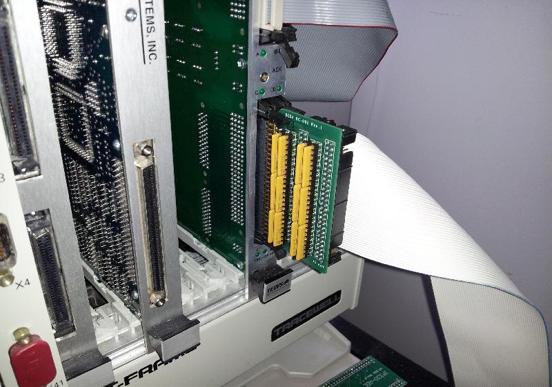

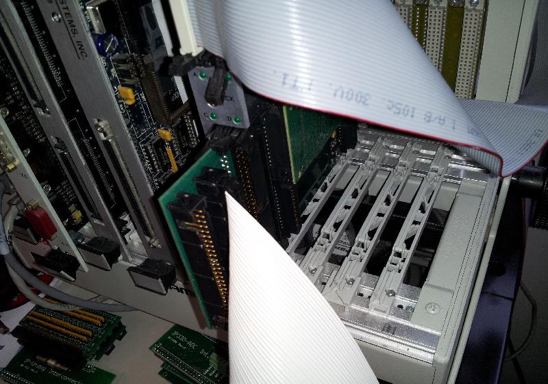

Closeup showing how to connect the BC-092 to the TEWS TVME-200 IP carrier.
Closeup of the other side of the BC-092 board. The ribbon connector closest
to the IP carrier (the J2 connector) handles I/O pins 1-24.
