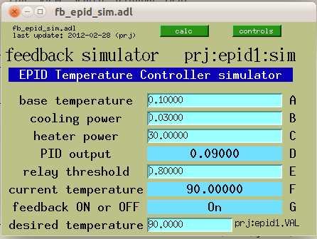

start a MEDM session with a command such as:
medm -x -macro "P=prj:epid1,C=:sim" fb_epid_sim.adl &
This screen provides access to the simulator, the swait calculation record, and the fb_epid controls that support it.
Figure: fb_epid temperature simulator controls

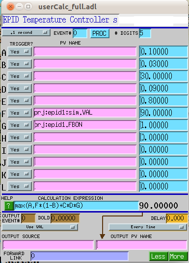

The calc button brings up this screen:
Figure: temperature simulator calculation
