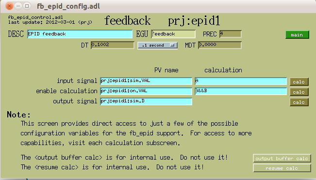

The configuration screen provides top-level access to the main components that must be addressed for basic configuration. Note that advanced situations must use the calculation screens to access the complete interfaces of the swait records.
Figure: fb_epid configuration screen
Caution!
The buttons marked output buffer calc and resume calc in the lower right corner are for internal use only. Do not change anything on these screens.

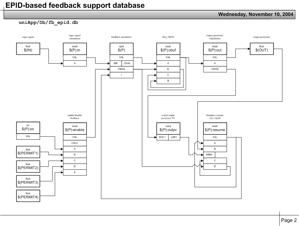

The EPICS database was constructed in 2004. The records of the database are defined in this table:
| record type | name | description |
| epid | $(P) | Epid record instance |
| swait | $(P):in | Input signal collector |
| swait | $(P):obuf | Enforces $(P).FBON to disconnect epid record from output so $(OUT) is not changed |
| swait | $(P):out | Output signal collector |
| sseq | $(P):outpv | Part of bumpless start feature |
| swait | $(P):resume | Part of bumpless start feature |
| bo | $(P):on | User switch to turn epid ON or OFF |
| swait | $(P):enable | Automatic ON/OFF feature |
| swait | $(P):sim | Simulated temperature reading and heater |
A figure was produced to show how these records are connected. Note that the simulator record ($(P):sim)is not shown in this figure.
Figure: Structure of the fb_epid database

# switch and retains the previous output value if the feedback
# software is switched off.
# 5. An output calculation is used to allow some flexibility
# for conditioning the output signal to the positioner.
# The conditioned epid result is pushed to the positioner.
# 6. A positioner responds to the result from the epid record
# and thus further modifies the input signal.
# 7. The feedback can be switched on manually, subject to
# the logic of some other calculation. For example,
# shutter closed could suspend feedback. In this case,
# the output is not driven.
# 8. When the feedback is switched on, the positioner should
# not jerk to a different position. The feedback software
# must be prepared to start moving the positioner from its
# present location.
# References
# epid http://cars9.uchicago.edu/software/epics/epidRecord.html
# swait /bcda/synApps/calc/swaitRecord.html
# PID tuning see the epid documentation (above)
# epid record to actually calculate the
# feedback response to the input
grecord(epid, "$(P)") {
field(DESC, "EPID feedback")
field(INP, "$(P):in")
field(FMOD, "$(MODE)")
field(FBON, "Off")
field(SCAN, "Passive")
field(KP, "0")
field(KI, "0")
field(KD, "0")
field(I, "0")
field(DRVL, "0")
field(DRVH, "0")
field(EGU, "feedback")
field(PREC, "4")
# Input calculation to the epid record
# Users can adjust the input based on a simple calculation
# or a more complex database resulting in this simple calculation
# By default, $(P):in.INAN is the PV name of the input signal
grecord(swait, "$(P):in") {
field(DESC, "EPID feedback input")
field(PREC, "5")
field(SCAN, "I/O Intr")
field(CALC, "A")
field(INAN, "$(IN)")
field(INAP, "1")
# Output buffer from epid record
# This record overcomes a limitation observed in the
# epid record when $(P).FBON=0 but $(P).OVAL is changed anyway.
# In this record, $(P):obuf.VAL will not change when $(P).FBON=0
grecord(swait, "$(P):obuf") {
field(DESC, "EPID FBON output buffer")
field(PREC, "5")
field(CALC, "B?A:C")
field(INAN, "$(P).OVAL")
field(INAP, "1")
field(INBN, "$(P).FBON")
field(INBP, "1")
field(INCN, "$(P):obuf.VAL")
field(INCP, "1")
# Provide the output from the epid record (through the output buffer)
# The intent here is to provide the user with a means
# of modifying the output signal from the epid record.
# Whether or not this is a good idea remains to be seen.
# This record pulls the value from $(P):obuf
# $(P):out.OUTN holds the PV name of the output positioner.
# Instead, could make this a seq record, eliminating the calculation.
grecord(swait, "$(P):out") {
field(DESC, "EPID feedback output")
field(PREC, "5")
field(CALC, "A")
field(INAN, "$(P):obuf.VAL")
field(INAP, "1")
field(OUTN, "$(OUT)")
# bumpless start feature
# When $(P).FBON transitions from 0 to 1 (as feedback starts up),
# it is necessary to grab the current value of the
# output positioner and push it into $(P).I
# However, since the user might change $(P):out.OUTN,
# $(P):outpv detects this change and rewrites $(P):resume.INBN.
# $(P):resume.INBN holds the PV name of the output positioner
grecord(sseq, "$(P):outpv") {
field(DESC, "follow OUT PV name")
field(DOL1, "$(P):out.OUTN")
field(DLY1, "0")
field(LNK1, "$(P):resume.INBN")
grecord(swait, "$(P):resume") {
field(PREC, "5")
field(CALC, "!C&&D?B:A")
field(INAN, "$(P):resume.VAL")
field(INAP, "1")
field(INBN, "$(OUT)")
field(INBP, "1")
field(INCN, "$(P):resume.D")
field(INCP, "0")
field(INDN, "$(P).FBON")
field(INDP, "1")
field(OOPT, "On Change")
field(OUTN, "$(P).I")
# permit
# Sometimes, the feedback software must be suspended.
# This must happen automatically, based on some
# simple calculation or a more complex database
# resulting in this simple calculation.
# $(P):enable drives the $(P).FBON field
grecord(bo, "$(P):on")
field(DESC, "off/on")
field(ZNAM, "off")
field(ONAM, "on")
grecord(swait, "$(P):enable") {
field(DESC, "EPID feedback permit")
field(PREC, "5")
field(CALC, "A&&B")
field(INAN, "$(P):on.VAL")
field(INAP, "1")
field(INBN, "$(PERMIT1)")
field(INBP, "1")
field(INCN, "$(PERMIT2)")
field(INCP, "1")
field(INDN, "$(PERMIT3)")
field(INDP, "1")
field(INEN, "$(PERMIT4)")
field(INEP, "1")
# drive the epid FBON field
field(OUTN, "$(P).FBON")
# simulate a temperature sensor and heater
# A : minimum "temperature" allowed
# B : cooling rate parameter
# C : heater power
# D : output of PID loop
# E : heater relay closes when D > E
# F : current "temperature"
# PID loop terms:
# $(P):in.INAN = "$(P):sim"
# $(P):out.OUTN = "$(P):sim.D"
# $(P):enable.INAN = "$(P):on.VAL"
# $(P).KP = "0.01"
# $(P).KI = "0.1"
# $(P).I = "0.0"
# $(P).KD = "0.0"
# $(P).DRVL = "0.0"
# $(P).DRVH = "1.0"
# $(P).FMOD = "PID"
grecord(swait, "$(P):sim") {
field(DESC, "EPID Temperature Controller simulator")
field(PREC, "5")
field(SCAN, ".1 second")
field(CALC, "max(A,F*(1-B)+C*D*G)")
field(A, "0.1") # minimum "temperature"
field(B, "0.05") # cooling rate parameter
field(C, "30") # heater power
field(D, "0") # driven by epid loop
field(E, "0.8") # relay close threshold
field(INFN, "$(P):sim.VAL")
field(INGN, "$(P).FBON")# is feedback ON?
To help learn how to use the fb_epid support, an swait record was added to simulate the temperature reading of an object that is exposed to some cooling power. A heater with adjustable power may applied, either as adjustable power or as a switched power.
