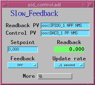

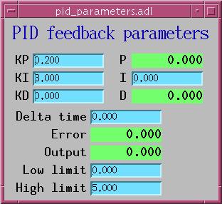

Implements a PID (proportional/integral/differential) feedback loop, reading values from a readback PV, comparing with a desired value, and writing corrections to a control PV. This record-based feedback loop is for low-speed applications, and is very general because it can use any EPICS PVs for readback and control.
pid_control.adl, pid_parameters.adl

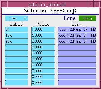

A general purpose selector, which allows the deployer to attach a menu to a list of actions. For example, to implement control of a motor for which discrete positions have special significance (mirror stripe, sample-wheel angle), one edits selector.substitutions (see iocBoot/iocStdTest) with the names and motor positions, and the target PV (or PVs) to which those positions should be written. The menu selection can be made by a client using ca_put_callback().
It's possible to configure the target PV at run time. If this is done, it's important to note that the links shown below in selector_more.adl must have the attribute "CA", because the record is configured to wait for completion, which can't be done with a PP link.
selector.adl, selector_choice.adl,selector_more.adl
