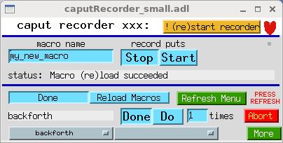

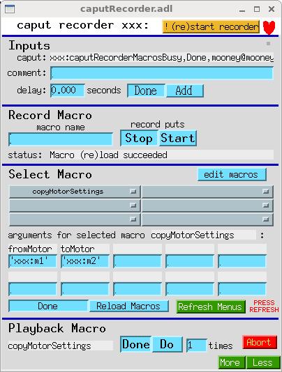

Referring to the caputRecorder.adl display above, from top to bottom:
The button labelled "!(re)start recorder" starts or restarts the python program caputRecorder.py.
The heart symbol to the right of the "!(re)start recorder" button blinks while caputRecorder.py is running and responsive to its control PVs.
Inputs
The text-monitor field labelled "caput:" displays the PV name and value most recently written to the IOC. This field is written to by the access-security trap listener, and is updated whether or not a python macro is being recorded.
The text-entry field labelled "comment:" allows you to add comments to the macro being recorded. This field is monitored only while a macro is being recorded.
The text-entry field labelled "delay" specifies the time delay in seconds
of the delay command that will be added to the macro being recorded when you
press the "Add" button. The actual python code for this command will be
something like time.sleep(1.200). After caputRecorder.py has
written the delay command, it will press the "Done" button.
Record Macro
The text-entry field labelled "macro name" specifies the name of the macro (python function) you will record.
By default, you aren't permitted to use a macro name that already exists in macros.py. (See Record options.)Also note that the macro name must start with a letter, and must consist of letters digits, and underscores. caputRecorder will enforce this by prepending "a" and/or replacing offending characters with underscores. The macro name will be truncated to 25 characters; this limit is set by the length of an mbboRecord's menu-string field.
The choice button labelled "record puts" is used to start and stop recording. While recording, you can write to EPICS PVs via any EPICS client, and you can also execute any macro that has already been recorded.
If you execute macro A while recording macro B, and then stop recording while macro A is still executing, caputRecorder will make you wait for macro A to finish before allowing you to start a new recording of another macro.
When you execute macro A while recording macro B, caputRecorder will suppress recording of the caputs that result from the execution of macro A, and will simply record a function call to macro A.
Select Macro
The button labelled "edit macros" invokes the command named by the environment variable EDITOR on the file macros.py.
The gray boxes are menus, which will contain the names of recorded macros, and they are the means by which a macro can be selected manually for playback. Currently caputRecorder supports six menus, each of which can hold 16 macro names.
The text-monitor and text entry fields under the "arguments for selected macro" label are the names and default values of the arguments, if any, of the selected macro. As recorded, macros have no arguments, but you can edit the python code. If you do, you must use the "name=value" syntax for defining macro arguments. For example, here is a macro definition with one string argument, and three numeric arguments:
def motorscan(motor="m1", start=0, end=1, npts=11):
Normally, you should not have to press the "Reload Macros" button, because caputRecorder reloads automatically after a new macro has been recorded. However, if you edit macros.py manually, you must press "Reload Macros" to tell caputRecorder to reread the file. (If you deleted a function definition from macros.py, reloading isn't sufficient; you must restart caputRecorder, using the "!(re)start recorder" button.)
The "Refresh Menus" button must be pressed whenever menus have changed. This happens when macro recording is done, after you press the "!(re)start recorder" button, after you press the "Reload Menus" button, and after the controlling IOC reboots. caputRecorder will tell you when menus need to be refreshed by showing the blinking text "PRESS REFRESH". This blinking text will go away when any instance of caputRecorder.adl, or caputRecorder_small.adl, is refreshed.
Playback Macro
The text-monitor field contains the name of the selected macro. To play it back (to cause python to execute it) press the "Do" button. When the macro has finished, the "Do" button will return to the "Done" state. If you want to execute the macro repeatedly, enter the number of times in the field labelled "times."
The "Abort" button is intended to stop an executing macro, and also to do any other abort-related work specified in the function named "_abort" in macros.py. The supplied example_macros.py defines an abort function that aborts scans, halts motors, and stop the scaler named "scaler1".

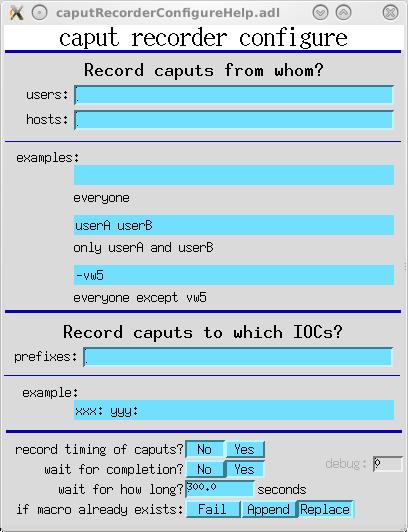

Any EPICS client or record can trigger macro execution by writing a macro name to "$(P)caputRecorderMacro", and then writing "Do" (or the number 1) to "$(P)caputRecorderExecuteMacro". The client should wait for completion after both writes, to ensure that any default argument values are in place before executing, and to wait for macro execution to finish.
caputRecorderUsers. (See "Record caputs from whom?" in
the figure below.) To disable recording from a specific user, put a minus sign
in front of the username.
caputRecorderHosts. (See "Record caputs from whom?"
in the figure below.) Only the first element of a host name need be specified. (For
example, "mooneylinux.aps.anl.gov" is used as "mooneylinux".)
caputRecorderPrefixes. (See "Record caputs to which IOCs?" in
the figure below.) Unlike user and host choices, this choice does not take
effect while a macro is being recorded. Also unlike user and host choices, this
choice is not about the sender of a caput, but about the recipient.
On startup, caputRecorder monitors the iocs whose prefixes are specified on the
command line. If caputRecorderPrefixes is not empty, it will
override the initial list of iocs.
The timing of caputs will, in general, be different on replay than when recorded, but you can tell caputRecorder to try to reproduce the timing. If you select "Yes" for "record timing of caputs?" (see diagram above), caputRecorder will insert delays between caput commands. You can change this setting while recording. Note that if caputRecorder waits for completion, the required delay time could be negative, in which case caputRecorder will insert no delay.
You can choose whether or not caputRecorder will wait for completion after executing recorded caputs, by setting "wait for completion?" (see diagram above). Note that this affects the python code written while recording, and is not an execute-time choice. You can change this setting while recording.
If you tell caputRecorder to wait for completion, you can tell it for how long to wait, using the text-entry field labelled "wait for how long?". You can change this time while recording.
If you attempt to record a macro whose name is already defined in macros.py, caputRecorder will do one of three things, depending on the setting of the "if macro already exists:" switch:
