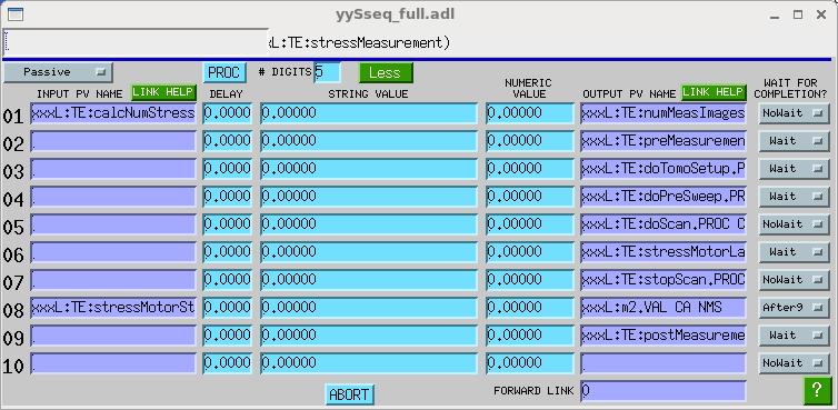

Here's a sample MEDM display of some of the the sseq record fields. Each "line" in the display consists of the fields DOLn, DLYn, STRn, DOn, LNKn, and WAITn, from left to right.

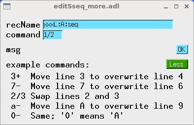

editSseq does all these things, with a simple command-based interface. Here's a sample MEDM display of editSseq:
To accomplish the change described above (move lines 1-3 of a sseq record to lines 2-4 of the same record), one would do the following:
editSseq also works on seq records.
