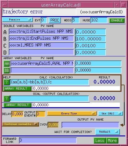

Here's a sample MEDM display of some of the the aCalcout record fields.
