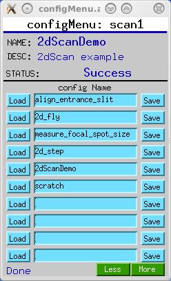

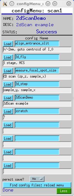

Suppose we want to configure a set of three sscan records to perform any of 10 different types of scans. Here are the steps needed to implement a menu of scan types, and to give the user a GUI display for creating scan types and loading them. (In the following, scan1 is the name of this instance of configMenu. The files it loads and saves will be named "scan1_<config Name>.cfg".)
Here an example of what the user might see:
- Create an autosave request file, which I'll call "scan1Menu.req", with the following content:
file configMenu.req P=$(P),CONFIG=$(CONFIG) file scan_settings.req P=$(P),S=scan2 file scan_settings.req P=$(P),S=scan1 file scan_settings.req P=$(P),S=scanHThis is required only if scan1 config files are to be written at run time.- Add the following lines to

In configMenu_small.adl, the menu of configurations is displayed by
and selected from the enum PV, $(P)$(CONFIG)Menu, (e.g.,
xxx:scan1Menu). This is the most convenient way for configMenu to
be driven by CA-client software, because a single PV contains the menu choices
and is also the PV to which choices are written to cause loading. This display
cannot cause a configuration to be written. When the menu is repopulated, MEDM
will not automatically retrieve the new names for display by
$(P)$(CONFIG)Menu. This must be done manually, by closing and
reopening the display, which is what the "Refresh menu choices" button does.
configMenu.adl and configMenu_more.adl show the menu choices as separate PVs, for which no manual refresh is needed, and provide buttons for loading and saving configurations.
configMenu_more.adl also shows description PVs. When the menu is
populated by searching for config files, descriptions are extracted from those
files. Otherwise, if configMenuNames.req is included in an autosave-request
file, names and descriptions will be restored at boot time. If the
enableSave PV (labelled "permit save?") has the value "No" (0), the
"Save" buttons will not be displayed, and users will not be able to save
configuration files.
