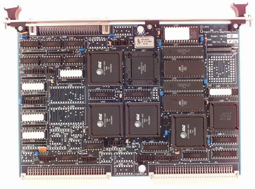

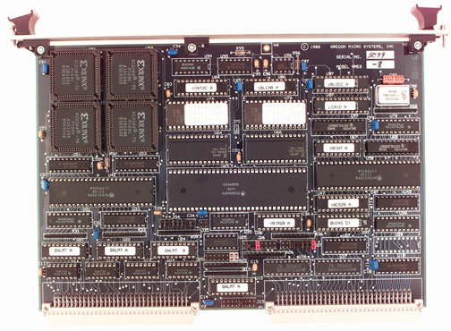

Compatible with drivers that accept step/direction inputs.
Oregon Microsystems, Inc.
1800 NW 169th Place
Suite C100
Beaverton, OR 97006
contact: Will Gallant (503) 629-8081
We have built transition boards to communicate between these boards and StepPaks or
other motor drivers that accept step/direction inputs. These signals are switchable between
differential (RS-422 standard) and single-ended, on a per-channel basis. With minor
modifications, they may be made to interface to other types of driver inputs, such as
step/step or optical.
