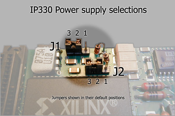

Power Suppy Selections (Pins of J1 and J2)
Power Supply Selection*
J1 (pins 1 & 2)
J1 (pins 2 & 3)
J2 (pins 1 & 2)
J2 (pins 2 & 3)
+/- 12 Volt (Internal, P1)**
Out
In
Out
In
+/- 15 Volt (External, P2)
In
Out
In
Out
* Internal and External Supplies should not be mixed (e.g. do not use +12 Volts with -15 Volts).
** The Board is shipped with the default jumper settings for +/- 12 Volt supplies as shown in the image above.
